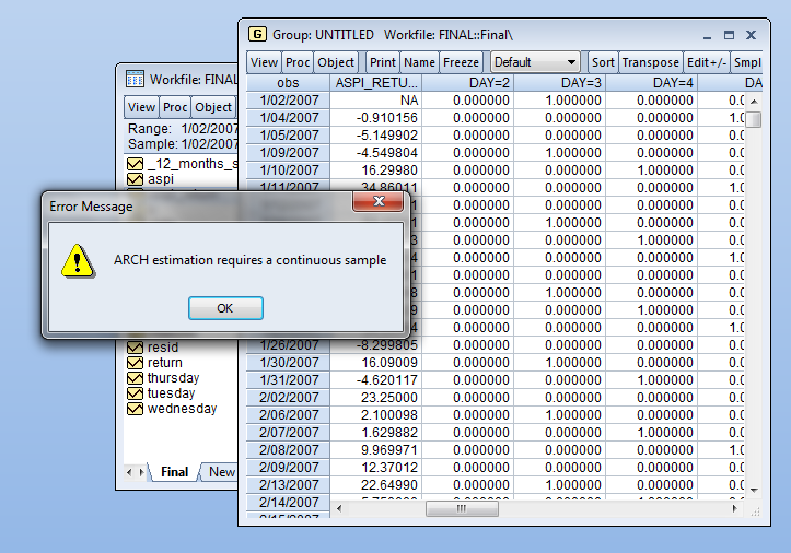

I'm a new one to this forum. I also doing a same research to examine the day of the week effect on ASPI index (Sri lanka). As you guys discussed above i have created a dummy variable for the week days using @expand command. But when i open my return series and that group dummy variable as a group and try to build up a GARCH(1,1) model, the following error message appears.
"ARCH estimation requires a continuous sample"
Why is this happening? Please help me....
