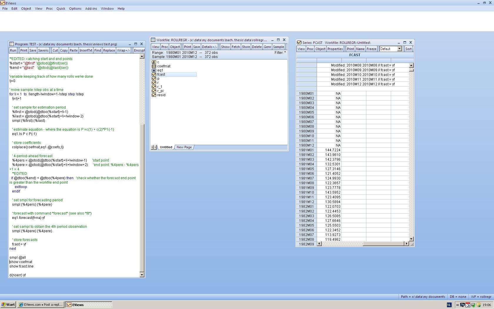

Re: Basic Rolling Regression
So what do I do wrong? Here is a screenshot where you can clearly see the spreadsheet from the 13th entry
- PrintScreen.JPG (209.2 KiB) Viewed 405518 times
EViews Esther
- Posts: 149
- Joined: Fri Sep 03, 2010 7:57 am
Please delete the fcast series before running the program?
That should do it, I'm sorry for the inconvenience!

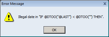

Hi Esther,
I ran this programe but says error
Please see screen shot.
- Untitled.png (3.44 KiB) Viewed 405258 times
EViews Esther
- Posts: 149
Please change the line to
if @dtoo(%end) < @dtoo(%4pere) thenCode: Select all
if @dtoo(%end) < @dtoo(%1pere) thenRe: Basic Rolling Regression
