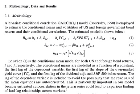

According to the model joined in the message we are trying to fit a bivariate conditional correlation GARCH(1,1) model (Bollerslev, 1990) through a set of data.
The question is, what parameters/variance regressors/ in the system and estimate equation panel need to be selected in order to obtain hi,j,t?

Actually help is much needed for this one! If anyone experienced a CCC GARCH model in Eviews, your toughs are welcome!
The problem is that with the click and play menu of Eviews 6 we can only specify 1 term of error, and this model requires 2 for proper results!
For exemple, if we run the prevous reply code we obtain the following:

BUT, for the Variance and Covariance Representations, we should have:
GARCH(i) = M(i) + A1(i)*RESID(i)(-1)^2 + B1(i)*GARCH(i)(-1) + C1(i)*GARCH(j)(-1)
COV(i,j) = R(i,j)*@SQRT(GARCH(i)*GARCH(j))
Any clues?
