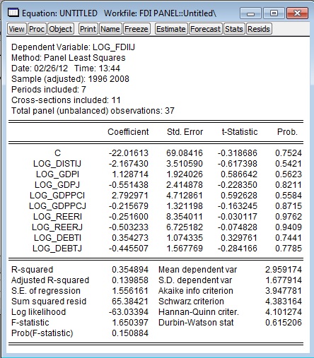

Hi everyone,
I have designed a gravity model to generate a result from the eviews. However, the result is unexpected.
Could you please help me to interpret them (see the attachment).
regards,
eviews result
eviews result.jpg (129.09 KiB) Viewed 2494 times

Postby startz » Sun Feb 26, 2012 8:49 am
You have 37 observations and nine variables. The results are that you don't learn anything.

Postby ansoufi » Sun Feb 26, 2012 10:27 am
I know that I have problem. Obviously, I am not an Eview expert that why I am asking.
why its unbalanced and only 37 observations.
regards
Re: Unexpected results
Postby startz » Sun Feb 26, 2012 12:28 pm
You probably have missing values. Take a look at your data and see if that's it.
