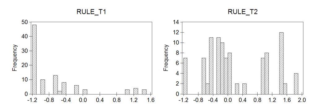

referring to my previous post, I was maybe too quick with saying that the suggested command worked fine.
graph1.textdefault font("Arial", 14) existing
I'd swear that when I first tested it (writing in the command window), it really worked.
However, I now noticed, that I does not work if I run this within a program, nor it work with graph objects that were frozen and saved with the workfile in a previous session.
So, what does the functionality of this actually depend on? Do I need more commands before / after this? Etc... Sorry I am confused. Help will be much appreciated. Thank you.

Hello there,
so I upgraded / updated to 7.2 Standard Edition Oct 14 2011 build.
I re-run my program. The proposed command
reset the "RULE_T1", "RULE_T2" chart titles and "Frequency" at the left vertical axes.
The axis fonts I needed to reset by additional commands
graph1.axis(id) font("Arial", 14)
Back to the manual option Quick Fonts, I tried to apply it on a previously created (frozen) graph object. It will set all fonts as wished, except for the size of the two chart titles font which is a number higher (e.g. pt 16, then title is pt 18).
So, neither of the two options (the command or the manual reset) is the same as what I had in mind as a ML user ("set this font everywhere").
But, okay for me the way it is. I appreciate very much your input and my apologies for the confusion with the testing.
