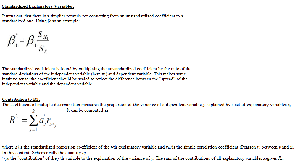

Assuming they aren't correlated, is the only way to figure out their individual contribution to the R2 figure by stepping each variable into the regression one at a time?
Take a peek at the attachment picture - does that seem logical?

Postby startz » Wed Sep 21, 2011 1:05 pm
If they're uncorrelated--which is unusual--you can just run separate regressions on each explanatory variable and use the R^2 from each.
