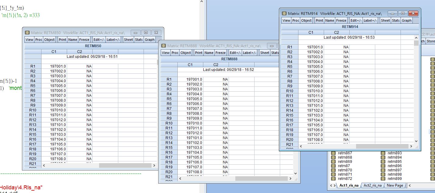

i have several matrix(more that 1000) with monthly frequency and need to combine to one, each matrix have 2 columns(c1 is monthly date, c2 is return), how to combine them all and with one monthly date?
i would like to turn matrix into group, but i can't use mtos because when i imported data i choosed dated regular frequency by daily...
Thank you so much!

Let's take a step back here. EViews can import your data into a monthly workfile. The trick is to indicate that the first column of data should be imported as characters, not a number. You'll then have the option to use that series as the date series for the workfile.

Thank you. I have solved the problem!!! :D
