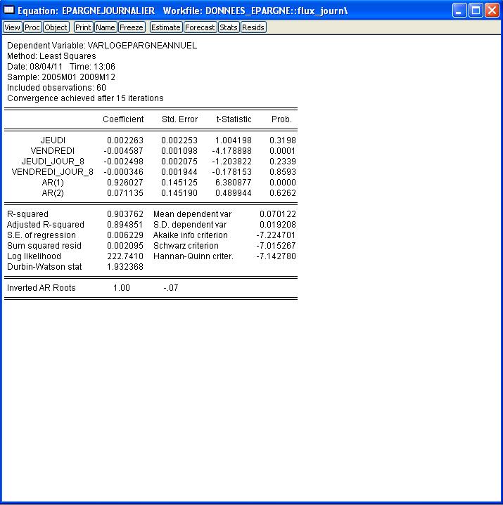

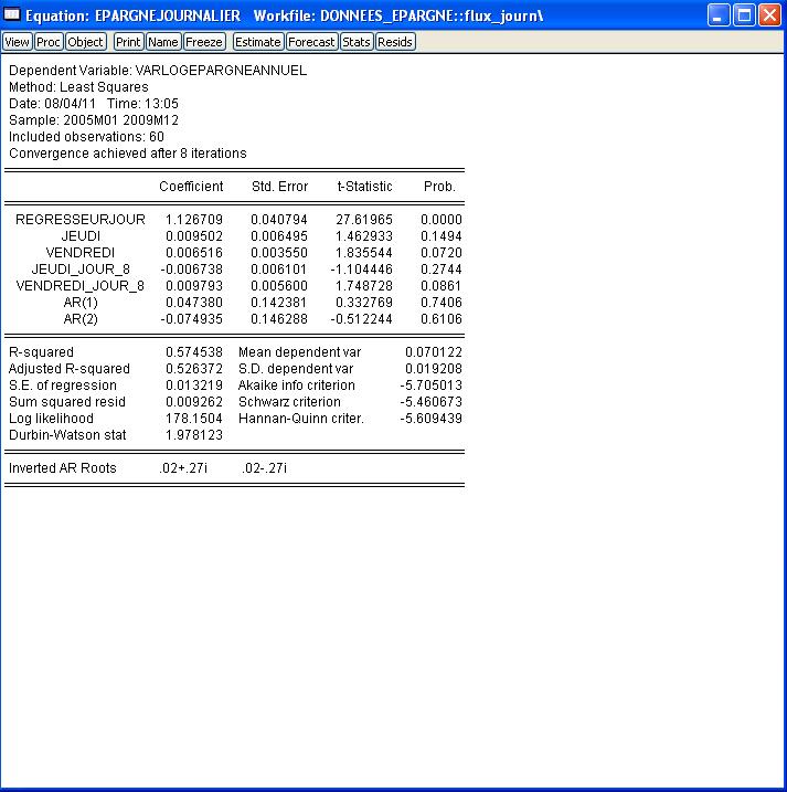

Hi startz,
thank you very much for posting help on this one! It was badly needed. Have a look at my estimation outputs below.. sample looks the same
- Image of complex regression
- regression lower r-squared.JPG (77.66 KiB) Viewed 6974 times
- Image of simpler regression
- regression higher r-squared.JPG (73.51 KiB) Viewed 6974 times

Re: R squared
Okay, that is indeed weird.
The AR terms make the estimation very slightly nonlinear, but I don't think that accounts for what's going on.
You might post your workfile and see if anyone sees something.

- Posts: 3798
Re: R squared
Quelle malchance. C'est dommage.
The answer is that you're having very bad luck.
Including the AR terms makes the estimates very slightly nonlinear.
Move REGRESSEURJOUR to the end of the regression list. Then estimate the equation without REGRESSEURJOUR. Now estimate the longer equation, setting the option for starting values at user supplied. You'll get a higher R Squared.

Emmanuelle
- Posts: 7
- Joined: Thu Aug 04, 2011 7:38 am
- Location: Quebec city
Re: R squared
wow! that worked just awesome!
c'est fantastique!
thank you forever...
