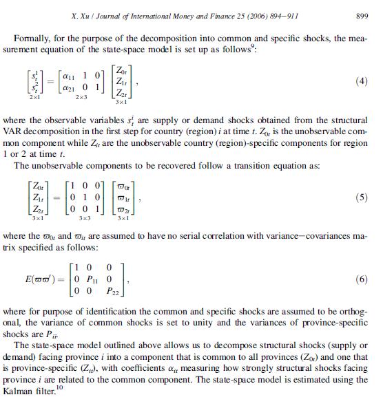

Can you please suggest if the following code is correct? I am trying to use a simple state space model to decompose structural shock generated using SVAR into a region-specific shock and a country-specific shock. This is a case of supply shock in a two-country setting. Here is my code:
@signal sup1 = c(1)*s1+s2+[var=exp(c(2))] @signal sup2 = c(3)*s1+s3+[var=exp(c(4))] @state s1=[var=1] @state s2=[var=exp(c(5))] @state s3=[var=exp(c(6))] param c(1) .0 c(2) .0 c(3) .0 c(4) .0 c(5) .0 c(6) .0
s1 is the region-specific shock which is common in both countries. s2 is the country specific shock for the first country, and s3 for the second country. I only have pure noise specification for the country specific shocks.
Estimating the model is consistently giving this message ''WARNING: Singular covariance - coefficients are not unique.'' Moreover, when I chose Proc/Make Model, I keep getting syntax error message.
Any suggestion would be highly appreciated!

Thank you. Can you please suggest where I have made mistake in specifying the following set of equations?
[sup1=[a1 1 0][s1] [sup2=[a2 0 1][s2] [s3] And, the eviews code I have is: @signal sup1 = c(1)*s1+s2+[var=exp(c(2))] @signal sup2 = c(3)*s1+s3+[var=exp(c(4))]
where the supply shock of country 1 is decomposed into the region-specific shock (s1), and the country-specific shock (s2), and similarly for country 2. The unobservable components have following specification (for state equation):
[s1]=[1 0 0][e0] [s2]=[0 1 0][e1] [s3]=[0 0 1][e2] again, the eviews code is: @state s1=[var=1] @state s2=[var=exp(c(5))] @state s3=[var=exp(c(6))]
and the error distribution is as follows:
E(ee') = [1 0 0] = [0 x 0] = [0 0 y]
Therefore the transition equations only have white noise specification with the variance of the common shock set to 1, and the variance of country-specific shocks (x and y) is to be estimated.
Please note that this is the specification in Chaime et al. (1994) and Xu (2006) used in decomposing SVAR shocks into a common component and idiosyncratic components.
Thank you again, and I look forward to your suggestion.

Sorry for the late response. I have attached a portion of the previous paper that I noted earlier. I am trying to replicate this for different countries. Please let me know where I made mistake in specifying these equations (in my codes posted previously), and can you suggest correction also.

The problem is, as Glenn said earlier, that the parameters aren't identified. This may be an error in the original article. However, it appears that the original author only cared about the ratio of common to regional variance, alpha^1/(alpha^1+P), which is identified.

The original article doesn't report estimates of alpha or P. I'm fairly sure that's because they can't be found.

In table 5a of the article, the author reports share of common shock using the alpha^1 and P1, which are parameters that were estimated using State Space model.
