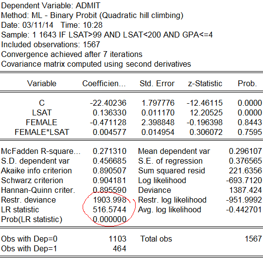

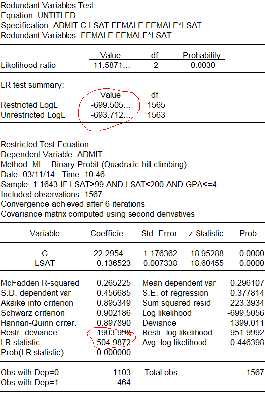

The following looks like a bug to me. I've done a redundant variable test following a probit (first attachment). The LogL values do not match the LR in the restricted model, nor in the original model (second attachment). In addition, I think the LR stat is off by a factor of two. Or maybe I'm misreading something???

You're missing something :)
The LR statistics are the ML equivalent of the F-statistics for the equation (against the base - constant only model). You want to be looking at the "Log likelihoods" which are used to populate the Restricted and unrestricted LogL rows of the Redundant Variables Test.
