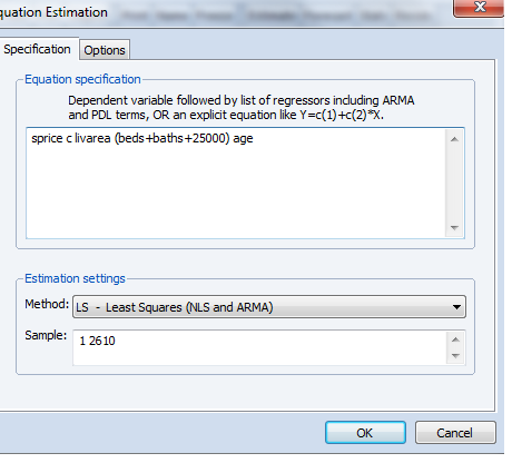

I'm new to EViews and would like to know how to test the hypothesis in the attached picture.
Any help is appreciated, thank you!
Forgot to mention I am using Version 7, and I took an educated guess regarding the estimation, is it something like this?

First, estimate the regerssion without the coefficient restriction imposed (not the way you show in your screen shot). That is, include beds and baths seperately as regressors. Then, after estimating the regression, go to coefficient restrictions, Wald test, and input your restiction as C(3)+C(4)=-25000 (careful that I've made the coefficient numbers here, you should use the coefficients specific to beds and baths in your regression, look that up under regression specification).
