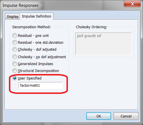

This thread is about svarpatterns add-in for just-identified SVAR models.
The add-in allows you to impose both short-run and long-run restrictions to obtain non-recursive orthogonalization of the error terms (as opposed to recursive Cholesky decomposition) for impulse response analysis that would make more sense from a macroeconomic/structural point of view. In order to use the add-in, you should first estimate a regular VAR model. After that, you can either supply the name of your model or the covariance matrix. The output will be a factor matrix, which can further be used in generating impulse responses, but NOT in conducting variance decomposition (see the picture below). In short, this add-in aims to extend the current functionality of EViews' Structural VAR estimation toolbox.
Use of factor matrix in impulse response

Does anyone know how to do variance decomposition after using SVARpatterns?
EViews only allow variance decomposition via Cholesky or structural decomposition (short OR long-run), but not when SVARpatterns is used.

by EViews Gareth
You cannot.
