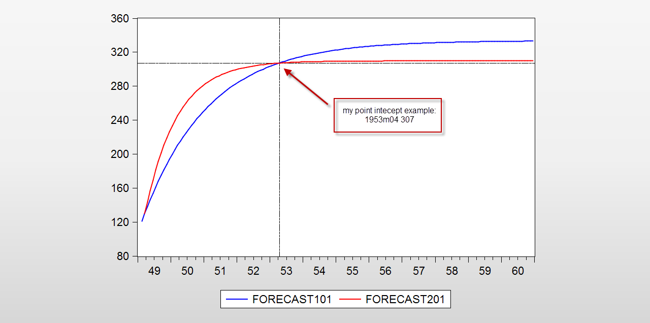

ecofin
Posts: 182
Re: DMtest - Diebold-Mariano Forecast Evaluation Test
Postby ecofin » Tue Jan 28, 2014 7:48 am
hi, thanks for your reply
is that I understood H0: equal expected forecast error, alternative H1: not equal expected error.
I have simple suggestion to Add line vertical and horizontal in graph to show the point of forecast101 intercept forecat201, and estimate this point in out put.
Best regards.
intercept forecast point.png (32.08 KiB) Viewed 66489 times
Posts: 13612
Postby EViews Gareth » Tue Jan 28, 2014 9:09 am
Your case is somewhat specific. How do you know the two forecasts are going to have an intercept? How do you know that they are going to have just one? They could cross 15,000 times!
ecofin
Posts: 182
Postby ecofin » Tue Jan 28, 2014 12:27 pm
hi
good question, I don't know but I have estime two models x c ar(1) the second x c ar(1) ar(2) for box-jenkins aire line passenger (just select 2 models for an example), I know They could cross 15,000 times. it is my mistake :oops: to understand that there are some models that can intercept in one point.
Best regards. ecofin
