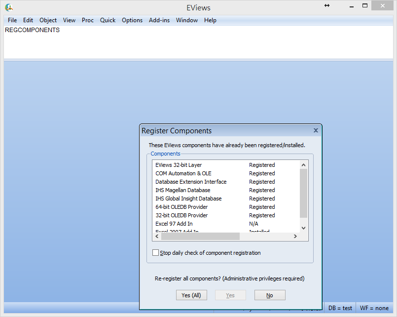

Seems like you lost your registration for the eviewsmgr.dll. You can re-register it by running EViews 8 64-bit and typing in REGCOMPONENTS into the EViews command window. Click Yes (All) to re-register everything.

Dear Steve:
Thanks for your quick response. I re-registered all components (as image), but it still cannot work. However, I follow "EViews COM Automation Technical Docu" (http://www.eviews.com/download/whitepap ... mation.pdf), I find that it is workable to call EViews from EXCEL VBA. That means the problems come from MATLAB? Or the COM ports of other software are conflict to EViews'?

Your copy of MATLAB is using EViews 7 whenever you specify "EViews.Manager" as the ProgID? When you run REGCOMPONENTS inside of EViews 8, that should take over that ProgID to point to EViews 8 64-bit.
If your MATLAB is still using EViews 7 after you do a "REGCOMPONENTS" inside EViews 8, then I don't think you are using a 64-bit version of MATLAB.

Postby EViews Steve » Mon Oct 14, 2013 8:42 am
When you ran REGCOMPONENTS before, did you click the "Yes (All)" button to actually perform the re-registration? Did you see the message that says "All components registered successfully." ?
