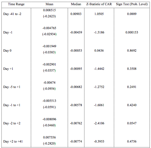

I am completely new to this program but it got referred to me by a friend to solve problems like mine. My task is to look at abnormal returns around the unlock date of lock-up agreements after an IPO. The dataset I created consists of an Dax index (first column) and than 10 columns of company stock prices. Each company has an observation range of -50 days before the unlock date, day 0 the unlock date and 50 days after the unlock date. The stock prices are placed next to the Dax for every day. (File is attached). I would like to know which commands i need to type into the "white box". Attached is also a file on what the output is kind of supposed to look like...

Step 2 using a z-statistic to test for whether the CAR is significantly different from zero. The z-statistic is equal to the sum of the t-statistics for the dummy variable coefficient for the five days surrounding the lockup date divided by the square root of the total number of regressions.
