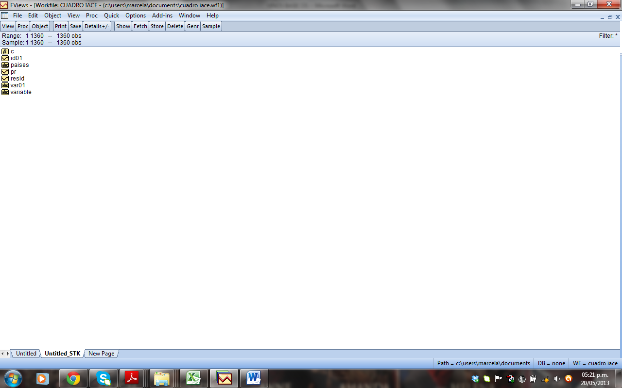

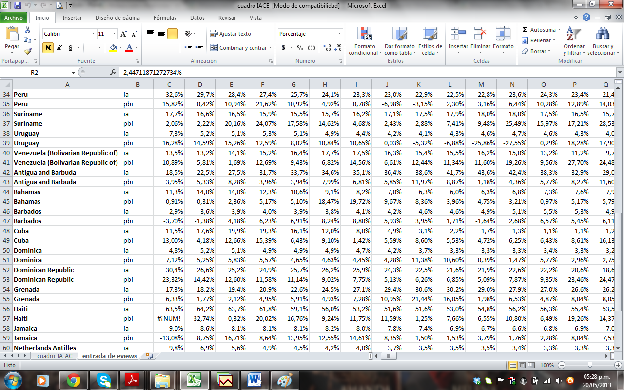

Hi i have this excel file and this workfile after stacked. I followed the step to stack the data but when I want unstacked as you explain in the topic "how to enter panel data in a workfile" I can´t do it .Could you help me?
I want evaluate the evolution of PBI and IA over the years in the diferent countries. Specifically my problem is how I can structure this excel file in eviews like panel data
thanks
how can I do to structure a panel data in a worfile

Re: how can I do to structure a panel data in a worfile
I'm going to assume that you want the dates to be the last part of the period (i.e. pr1990-92 will become simply 1992).
You appear to have some data problems with Saint Kitts, Saint Lucia and Saint Vincent. They have two IA variables, rather than an IA and a PBI.
Assuming you fix those, then the following code should do it for you:
wfopen "cuadro iace.xls"
pagestack pr?
series year = @dateval(@right(var01,2), "YY")
pageunstack variable paises year
pagestruct @date(year) paises
delete pr
rename pr* *
