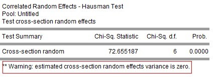

I use 2sls to estimate coefficients for 2 equations. After running 2sls with random effect, I did hausman test to see whether random effect is appropriate for each equation. However, based on the result, it shows that it's proper to use fixed effect in equation 1, while random effect in equation 2. Is it normal to have different effect in one model?
THanks for reply!
Also, I attached 2 pictures showing the result of Hausman test. Please see the words in red box. Could you explain what do they mean? Do they mean that I cannot judge the effect based on p-value<.05?

The second result is telling you that the estimator of the random effects gives you results which indicate that there are no random effects (the variance is zero). The first result indicates that the Hausman test is obtaining an invalid variance, probably because of small sample issues. It's hard to say, but my first guess is that your samples are so small that the estimators don't have enough data to determine much of anything.
