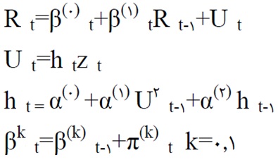

However, I dont want to estimate a GARCH(1,1) using a state space model. I want to estimate the time varying beta using and AR model while relying on GARCH (1,1) in estimating the volatilities.
In other words, is it possible to use the GARCH (1,1) in the State Space model for estimating time varying betas as per the attached document.
Your swift response will be highly appreciated as I am in real need to understand and implement this.
Re: Estimating state space model for GARCH(1,1)
Posted: Sat Sep 15, 2012 12:03 pm
by trubador
The model is nonlinear in state variables, so as I mentioned before, it cannot be estimated via linear state space approach. Nonlinear state space models are quite complicated and therefore are very difficult to estimate. In addition to this technical detail, your model is so flexible that you may experience additional problems during estimation even if you manage to find a way to build it.
