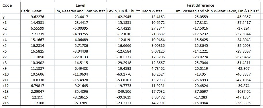

Hi, I'm doing my thesis report, I have a panel data, to have the panel Unit root test, I choose Hadri,Im, Pesaran and Shin and Levin, Lin & Chu methods. But while dealing the result, I have trouble to get the conclusion, all the variables have less than 5% P-value. Besides,Im, Pesaran, Shin W-stat and Levin, Lin's Null Hypothesis are both Unit root. But Hadri's Null Hypothesis is Stationarity. What can I get if I can't reject any of them. More than that, I can't even get the critical value when testing variables, anybody knows why?

My thesis before also used panel data. for unit root testing in panel, you should choose the test that you prefer out of the several tests available. In my thesis before, in selecting the test result, I rely on the result of ADF Fisher Chi square test. I prefer ADF Fisher test because it does not require a balanced panel unlike the test for (IMPS). Also, the Fisher test can use different lag lengths in the individual ADF regressions and can be applied to any other unit root tests (Baltagi). you can read more in econometric text book by Baltagi "Econometrics Analysis of Panel Data". You can see it on the attachment below. If you use Eviews, you can read in Eviews help to find some information about panel.
If you are familiar with eviews, eviews will have a shorter output that gives an easier interpretation. good luck!!
