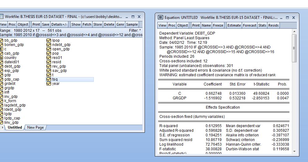

Estimating a simple model for the period 1985-2010, excluding 5 countries because there is some missing data, I obtain the following results:
Regression of debt_gdp on gdp_growth.
I get a bit confused how to interpret correctly ratios and what is the meaning of "-1.51", standing for Beta1. Does that mean that 1 % point increase in gdp growth would lead to a -1.51% point reduction in the debt/gdp ratio or? Furthermore, when I take a look at the country effect, it gets even more confusing for me:

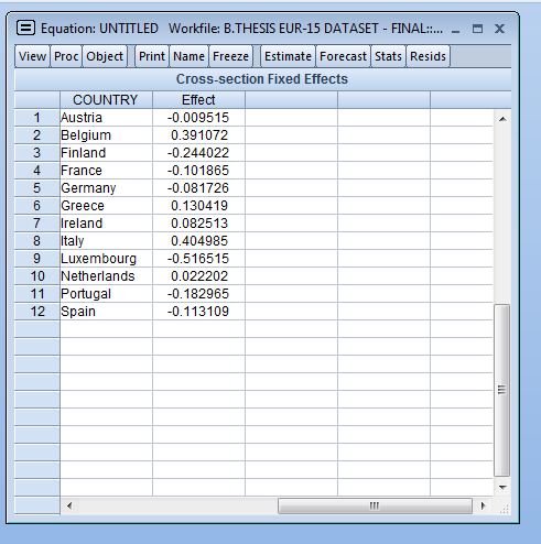

Cross-section Fixed effects
Taking a look for Portugal, it seems that if gdp_growth is 0%, then Portugal's constant would be -0.18, implying that the country should be a NET LENDER to World, lending 18% of its GDP. This doesn't make any sense, as their Debt/GDP now is around 0.90 and growing.
