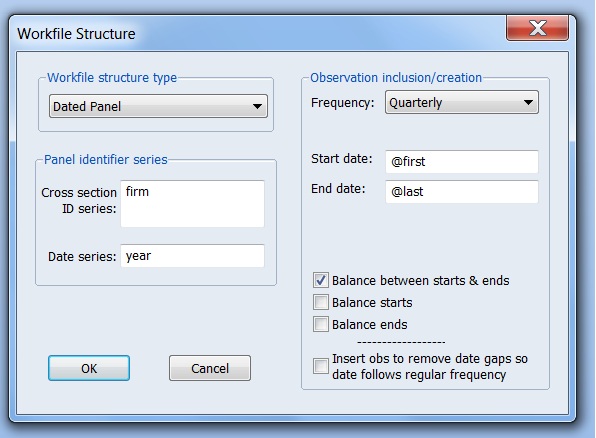

When you click on the Proc/ Structure/Resize Curent Page in the current workfile, what does it say?
Re: Panel Data - Fixed Effects
Posted: Wed Feb 01, 2012 3:48 pm
by gastonpresente
Hello Glenn
I have attached a frame of what appears when I do that..
Eviews Resize.jpg (69.98 KiB) Viewed 217007 times
What do you think? There is no need for the dummies, right?
Thanks for your help

Does your YEAR variable indicate Year and Quarter? The built-in period effects will be for whatever is defined by YEAR.
Glenn
Hello
Thanks for your help.
Yes. Year is both.
2009Q1
2009Q2
2009Q3
2011Q4
so I do not need the dummies... Am I right?

You're fine on the period effects. They'll be at the quarter level. If you go to the View menu you'll see an entry Fixed/Random Effects, where you can look at the estimated values.
