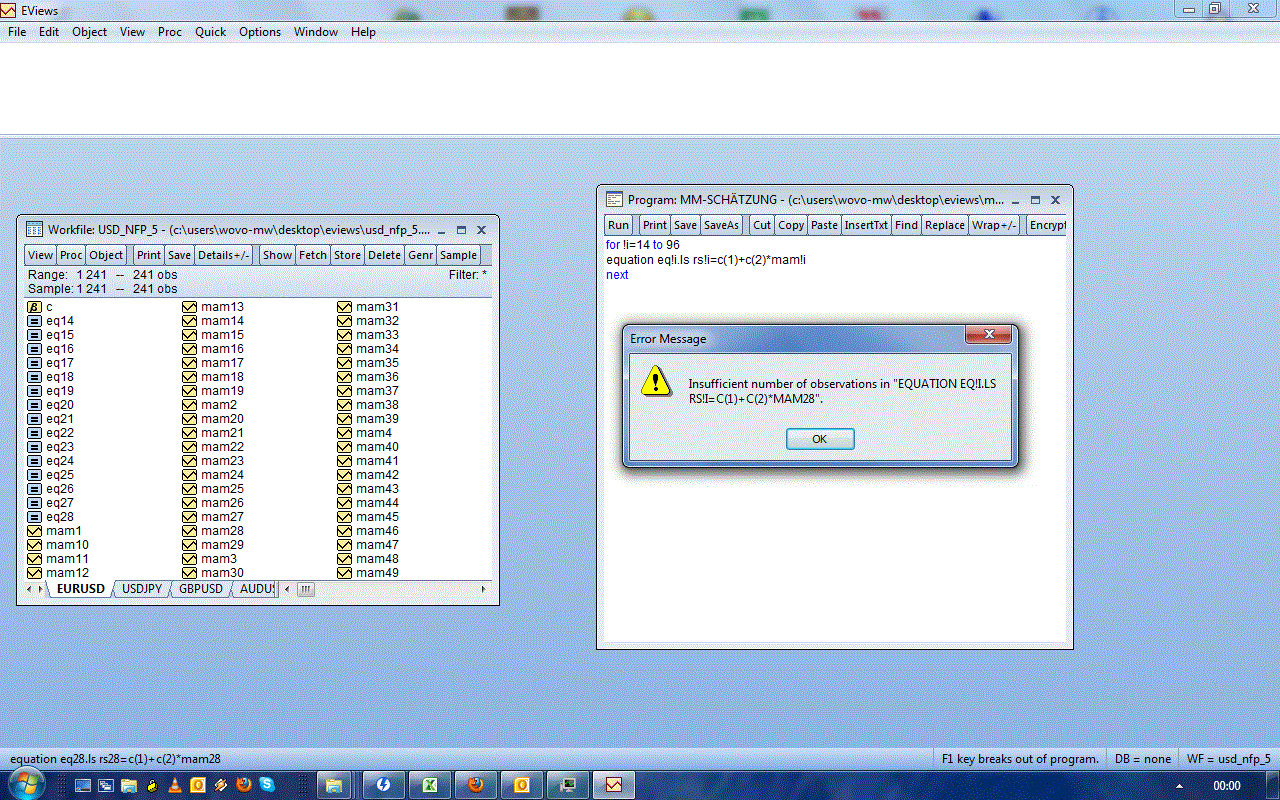

However, with some of the datasets there appears to be an issue as i get the message "insufficent number of observations" - no equations are written for these datasets and the process terminates. I've checked the datasets thoroughly, they are all of the same lenght (241 entries).
Any hint how to automatically get estimations for all datasets? (The mistake also appears if I create the equations manually, as indicated above [without the "for" clause])

- Screenshot of error message
- Unbenannt.gif (222.75 KiB) Viewed 9455 times

the program finds this mistakes, and even in datasets, that do not have this issue (see e.g. the screenshot example with rs28 and mam28m, which are perfectly ok as far a I can see!). It's about those instances that I care...I'll ignore the empty data sets (I think 13 is the only set with this problem with this issue in the whole database)...
What about the mistake with regards to those sets that are/look perfectly fine?
Thanks!

Moreover:
When i run the programme repeatedly, the mistake occurs in different runs with different data sets!
For example:
- 1. time: when i ran it for 90 - 96, first there was a mistake at 92
- 2. time: when i ran it again (without change), there was a mistake at 90
- 3. time: when i ran it the third time, there was no mistake at all!
Each time there is a mistake and i doubleclick the respective equation it says "Equation estimates are not valid".
What can i do? If I had to estimate only those 96 equations I would simply write down the results as soon as I get them
(repeat the procedure until I collected reasonable results for all equations [without number 13])
the problem is: I have to estimate approx. 12.000 equations in this manner (120 times databases with 96 time series),
so I really need to automate this thing...!
Any help with this issue?
Thanks!
