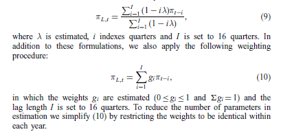

Thanks for your answer, it helps a lot. At first, I thought exactly the same, and tried to code it in the logl-object. The thing is that phi_l is approximated by several different specifications, as seen in the picture below.
Its just that my supervisor told me that phi_l should be estimated separately, but on the other hand he does not know eviews.
But do you know if its possible to code equation (7) and substitute phi_l with eq. (9) or (10)? I´ve tried that but found it very difficult.

Postby EViews Gareth » Mon Jul 18, 2011 6:06 pm
I'm reasonably confident that cannot be estimated in EViews yet.
