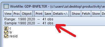

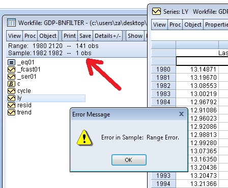

I'm trying to apply the add-in on a series of log(gdp) with annual data of 41 obs. and with p=1 and q=1. However, no matter what I set the parameters, it always results in error, "error in sample: range error". Also, I'm not sure how to decide on that "parameter value" (s). please help! (Using version 7.2)
Note: I noticed that the program expands the workfile range by the value of the parameter "s" but the sample range is reduced to consist of only one observation. (see attachments)
when the BN filter is applied
before applying the BN filter
