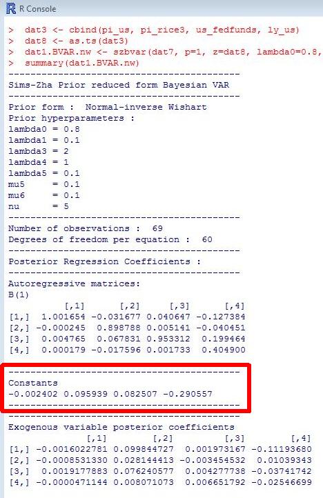

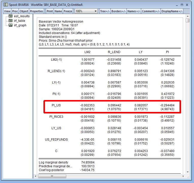

It seems that although the BVAR add-in correctly calculates the parameters when including exogenous variables using the Sims-Zha Normal Wishart prior, it does not report them correctly.
If one compares the results from EViews with those from the "R" programme "MSBVAR" (which was the basis for the original add-in) in this situation, it seems that EViews picks up the value of the estimated constant and places it in the table position for the first exogenous variable, then displacing all the other coefficients downwards one row, so that eventually the reported constant is actually the coefficient of the last exogenous variable. This should be easy to fix.

Returning to this post, I attach for information 2 jpg files indicating the precise reporting problem, should it be of help.

- MSBVAR results

- EViews results
- BVAR_test6.jpg (94.18 KiB) Viewed 7657 times

I am sorry about the error. I fix the problem in the new version.
Regarding upon a constant "C", while KoKo options will let you choose whether to put "C" into a model (please note that the second dialog will ask you whether to include the intercepts),
Simz-Zha options will include a constant "C" by default. When you write your variables in the first dialog, please do not specify "C".
