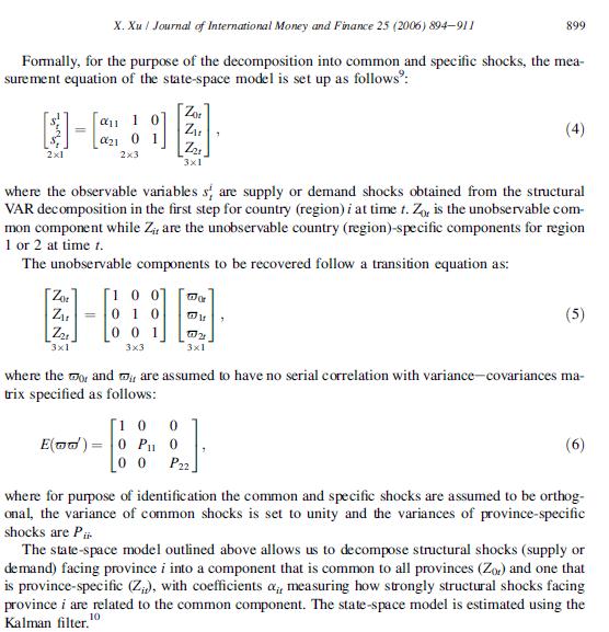

Sorry for the late response. I have attached a portion of the previous paper that I noted earlier. I am trying to replicate this for different countries. Please let me know where I made mistake in specifying these equations (in my codes posted previously), and can you suggest correction also.

The problem is, as Glenn said earlier, that the parameters aren't identified. This may be an error in the original article. However, it appears that the original author only cared about the ratio of common to regional variance, alpha^1/(alpha^1+P), which is identified.

There are several other papers which has taken this very approach and haven't reported anything different. So I am wondering where the error might be.
Re: Decomposing shocks using State Space models
Posted: Tue Jun 14, 2011 3:11 pm
by startz
The original article doesn't report estimates of alpha or P. I'm fairly sure that's because they can't be found.
Posted: Tue Jun 14, 2011 3:41 pm
by nectar
In table 5a of the article, the author reports share of common shock using the alpha^1 and P1, which are parameters that were estimated using State Space model.
Posted: Tue Jun 14, 2011 3:47 pm
by startz
But he doesn't report the individual parameters, does he? Just the share? The problem is that you're trying to estimate the individual parameters.
Posted: Tue Jun 14, 2011 4:49 pm
by nectar
But how can he report share without estimating the individual parameters? Is there a way to do that?
