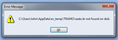

Further to this, my attempts to use TRAMO in EViews 7.1 have been frustrated by the repeated error message shown.
I am guessing that this has something to do with where EViews is installed (in my case in C:\Programmes\EViews7) but have no idea what to do to make it work.
Can you help?
Regards
