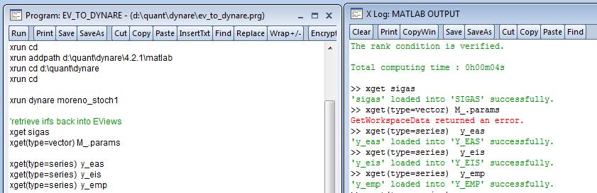

Perhaps one can, but I have failed... See the attached for one attempt. I also tried various other xget "type=" options, and none at all, with the same result. There may be some other appelation for "M_.params" which works, but "m_.params", "M_params" and "params" do not. And of course using "xget M_" directly just returns a scalar with value "NA".

EViews prog and results
Matlab workspace

I'm pretty sure that if you put M_.params into it's own separate matrix (within MATLAB) first, you can then download that new matrix variable to EViews with an XGET call.
This limitation is due to their own COM interface so it would be something they would have to change in order to allow a call to GetWorkspaceData M_.params (which is what the EViews XGET method calls) to work directly.

Postby EViews Steve » Fri Jul 29, 2011 10:26 am
It looks like the MATLAB COM interface won't let you use compound statements in the call to GetWorkspaceData. Meaning, you can't call "func(M_.params)" to get your data. And from what I can see, there's no reason why you couldn't just call XGET M_.params aside from this limitation.
So here's what you should do:
Create a temp variable in MATLAB that copies the compound item you want to retrieve like this:
XRUN "tmp2=M_.params"
Then retrieve it using the name parameter to change the name in EViews:
XGET(type=vector, name=params) tmp2

Postby donihue » Sat Jul 30, 2011 4:37 am
Thank you very much indeed, Steve. That worked a treat!
