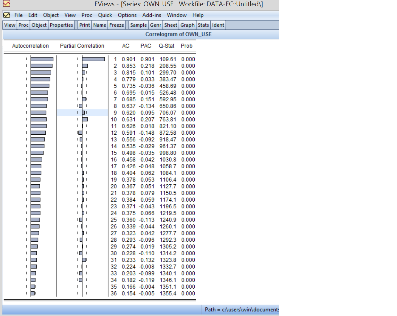

flourence
Posts: 5
Joined: Sat Oct 21, 2017 3:56 am
Re: test for seasonality
Postby flourence » Wed Nov 29, 2017 1:09 am
After browsing in how to detect seasonality in data i found out that if your AC in correlogram shows up and down movement repeatedly it shows seasonality . Example is this. Can someone verify this
