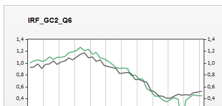

When I use my own copy of EViews 14 and run an add-in to format a graph object that includes the following command:
{%gr}.options size({!width}, {!height}) frameaxes(lbrt) framewidth(0.5) gridwidth(0.5) gridcolor(ltgray) gridcust(year, 1) fillcolor(@rgb(255,255,255)) backcolor(@rgb(255,255,255)) color background backfade(none)
I get the expected graph, which is embedded in a spool object.
Skjermbilde 2025-11-15 104916.jpg (15.84 KiB) Viewed 31342 times

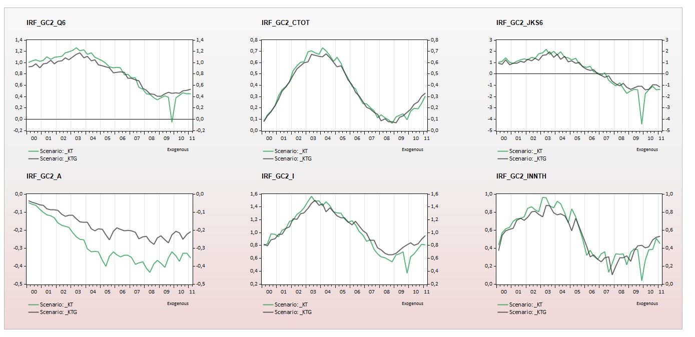

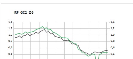

However, when EViews runs automatically on a server and calls exactly the same programs, the resulting graph is different.
Skjermbilde 2025-11-15 111519.jpg (15.1 KiB) Viewed 31342 times
In particular, the background fade effect (backfade) appears even though I specified backfade(none).
Why does the backfade behave this way on the server? Could there be some global setting or configuration in the EViews version on the server that overrides this option? What might be causing this difference?

Re: backfade ?
Posted: Mon Nov 17, 2025 8:51 am
by EViews Gareth
Options->Graphics Defaults is the easiest way to do it.
It looks like your graph does have no background fade - it has a solid grey colour (i.e. no fade). If you want it to match yours, you probably want to make the background colour white, not grey:
{%gr}.options backcolor(@rgb(255,255,255))
