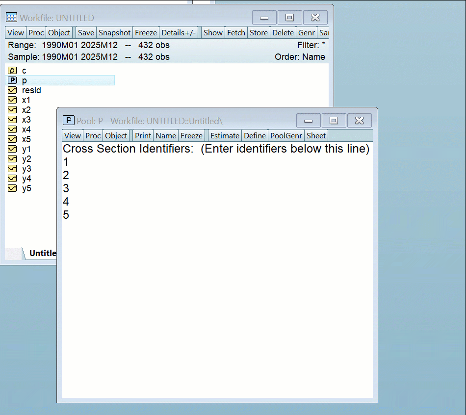

Could you provide exact steps on what you're doing? I ran a quick test and it seemed to work ok, but I think you're doing something different.
