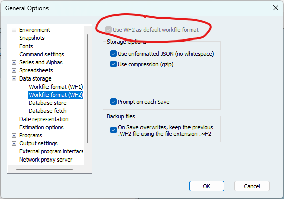

Postby EViews Steve » Wed Jan 22, 2025 9:21 am
I'm confused. Are you saying the WFCREATE command defaults to WF1?
Our workfile save format default is controlled by a setting under General Options/Data Storage/Workfile Format (WF2):
Screenshot 2025-01-22 081620.png (30.97 KiB) Viewed 68589 times
When you run the WFSAVE command, and you don't specify a file extension, the file is saved using the default workfile format type.
And you can overwrite this default by either specifying a file extension or using the "type=wf2" option.
