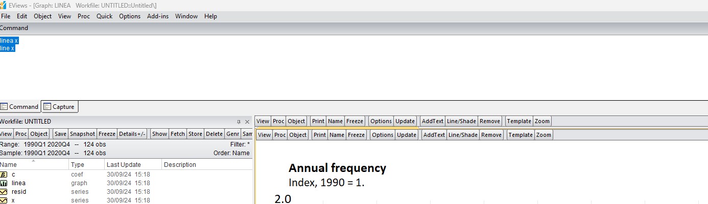

when you install the attached prg-file as an addin named LINEA, and then execute the commands:
linea x
line x
EViews shows strange behaviour and stops working.
linea .jpg (88.59 KiB) Viewed 44661 times
Panes and tabs mode is activated.

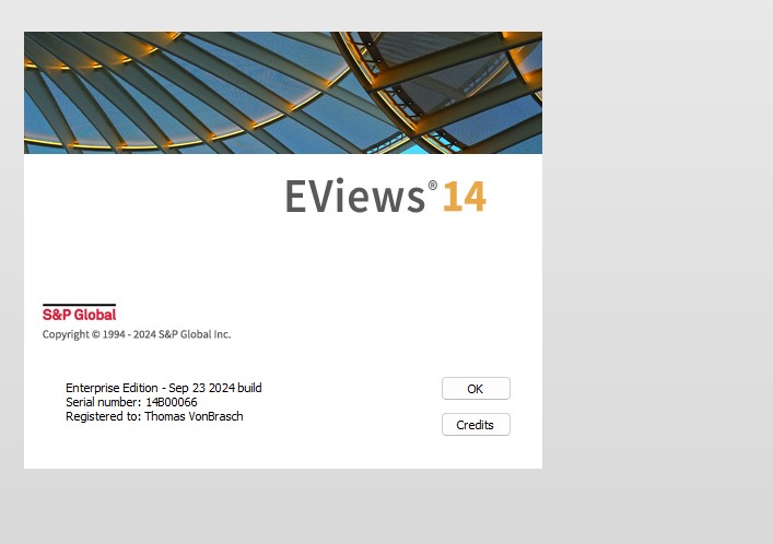

Postby tvonbrasch » Tue Oct 01, 2024 8:10 am
yes:

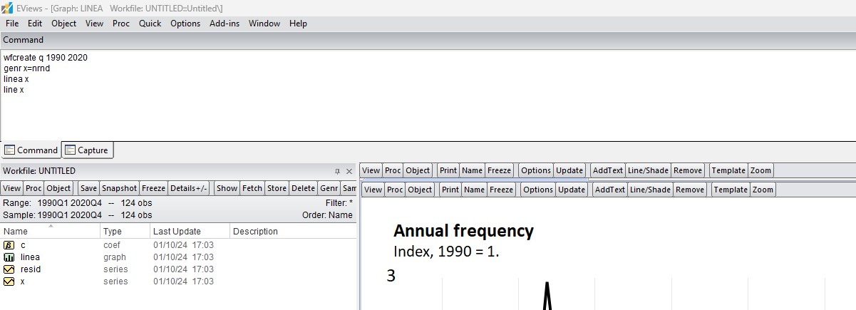

these are the commands I use:
Skjermbilde 2024-10-01 170418.jpg (88.67 KiB) Viewed 44604 times
and with the last line command, there is an error with the graph object (view, proc buttons are on top of each other), and then the program stops.
