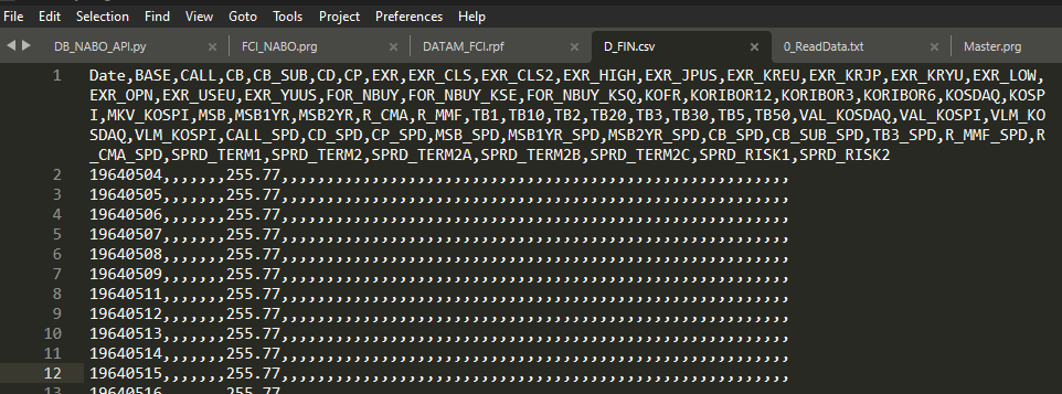

The csv file contains daily data from 05/04/1964 to 09/20/2024 of 64 series. The first column is "Date" formatted as yyyymmdd. The problem is EViews does not read columns after "EXR".
I'm using EViews version 13 at home and version 14 at work. Both versions have the same problem.
Data in CSV file:

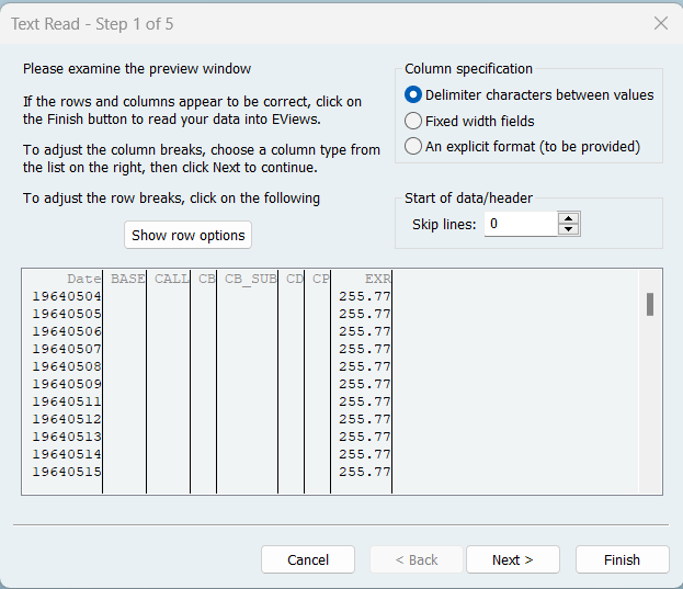

Data in EViews:
Currently, I have the following line, where %freq is one of "A" "Q" "M" "D":
import %tmp_file ftype=ascii rectype=crlf skip=0 fieldtype=delimited delim=comma colhead=1 namepos=all eoltype=pad badfield=NA @freq {%freq} @id @date(date) @smpl @all
The line works well with frequencies "A" "Q" "M", except "D". My guess is it is because of many blanks at the beginning of the daily data after "EXR".

Ok, I think the fact that your CSV file has a lot of values that are missing (NA) is causing the issue. Our import wizard tries to figure out how much data to import based on looking ahead and counting how many values exist for the first certain number of rows (I don't remember the exact row count) and judging from your data, it looks like the rows mostly only had data up to the EXR column, which is why the import wizard stopped there.
I noticed that the last few lines of data in the text file had more data values, so I reversed the order of the rows (after the header) and imported that. This resulted in a lot more columns being imported, but it still dropped a lot from the end since they didn't have any data.
I did find these two IMPORT elements (available during a text file import, see here) which, I believe, fixed the issue:
