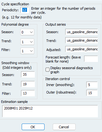

Thanks for getting back, I mean how the seasonal part is forecast using the forecast length options
Screenshot 2024-03-28 175154.png (18.85 KiB) Viewed 34423 times
Last edited by Cscottmcwall-ea on Thu Mar 28, 2024 10:52 am, edited 1 time in total.
Re: STL Forecasting
Postby EViews Gareth » Thu Mar 28, 2024 10:30 am
I'm not sure I understand what you're asking, sorry. Are you asking how to do the seasonal forecast, or how EViews does it?
If the latter, the Help section has details here:
https://eviews.com/help/helpintro.html# ... 23ww161272
(scroll down to the paragraph starting with The Output series...)
Cscottmcwall-ea
Posts: 8
Joined: Mon Mar 11, 2024 6:09 am
Re: STL Forecasting
Postby Cscottmcwall-ea » Thu Mar 28, 2024 10:54 am
ah yes didnt see that, this is what i needed Thanks!
