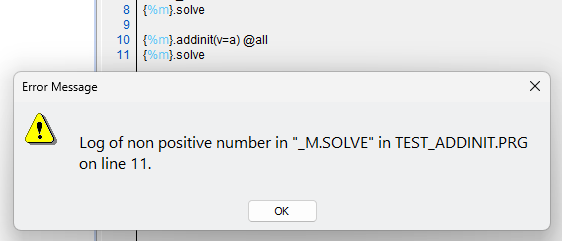

Postby tvonbrasch » Fri Feb 02, 2024 7:57 am
If you first solve a model, then use addinit(v=a), and then solve the model again, why can the solver then terminate?
I thought that the residuals would be set to the values they had in the first simulation when using the addinit(v=a) command. What could cause the solver to terminate when the addinit-command is used in this way?

It's possible that if solution values (or expressions they appear in) are very close to numeric singularities, then the adjustment of add factors combined with the solution rounding and significant digits setting could produce such failures. Here's a small program that demonstrates this effect:
create u 10 series x = 3e-8 series x_a = 3e-8 model m m.append x = x(-1) m.append y = @log(3.3e-7 - x) m.addassign x m.solve m.addinit(v=a) @all m.scenario "Scenario 1" m.solve
