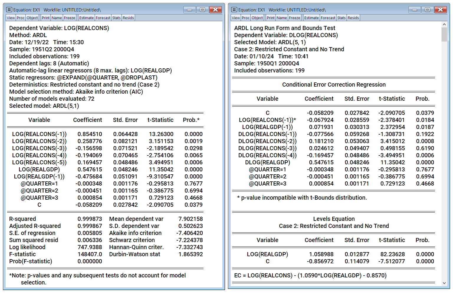

    Consider the example output below:
    In the image on the left, you can see the equation in levels. Moreover, the denominator in the expressions in equation 29.5 is
    1 - sum(b_(0,i) = 0.0679242020571
    Then, the long-run coefficient for REALGDP is derived as
    LR_REALGDP = b_j / (1 - sum(b_(0,i))) = (0.547615... + (-0.475684...)) / 0.0679242020571 = 1.05898752656
    This number is identical to the values you see in the table titled "Levels Equation" in the image on the right. However, that number can also be derived from the CEC form by dividing the coefficient on the lagged independent variable of interest (i.e. REALGDP(-1)) by the coefficient on the lagged dependent variable (i.e. REALCONS(-1)). In other words:
    1.05898752656 = 0.071931.../-0.067924...
    These are two equivalent ways of deriving the same thing.
    3) The coefficients associated with the error-correction form are entirely different (although still related), and they can be displayed if you proceed to View/Coefficient Diagnostics/Error Correction Form
So to sum up... the output produced under the "Levels Equation" of the "Long Run Form and Bounds Test" does indeed display the long-run coefficients.
