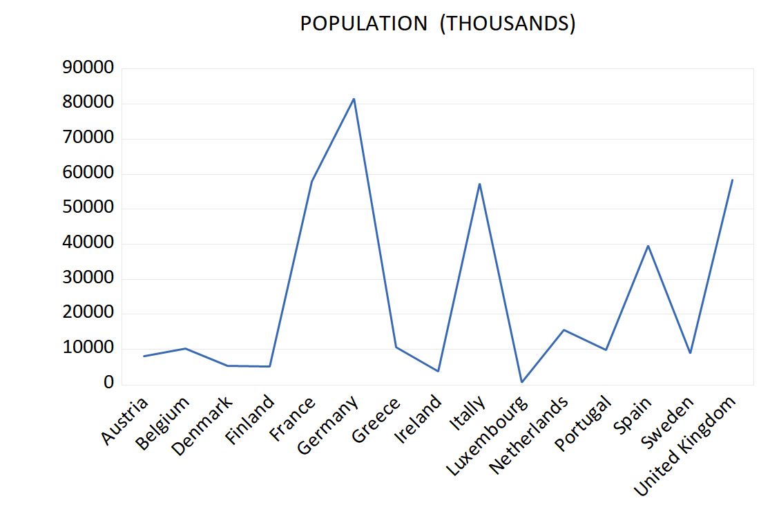

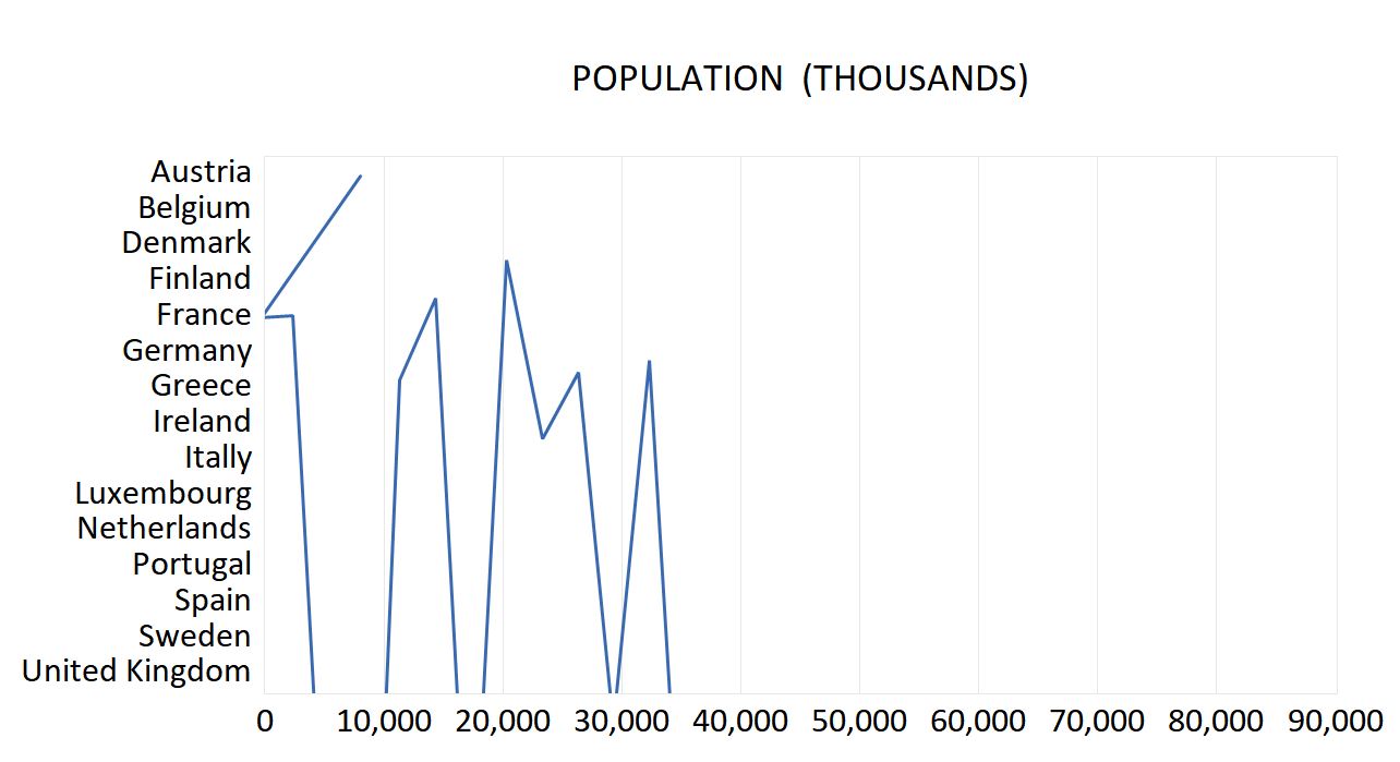

It seems that in EViews 13 "Graph option - Rotated - obs axis on left" works improperly for "Line & Symbol" and "Area".
In EViews 12 this option works fine.

Hi, Gareth,
Please try, for instance, file eupop.wf1 from EViews manual and rotate data represented as line or area.
Another good example in this season is your nice New Year Tree from: http://www.eviews.com/blog/xmas.prg. Try it in EViews 13 and you can see the problem. EViews 12 works properly.
