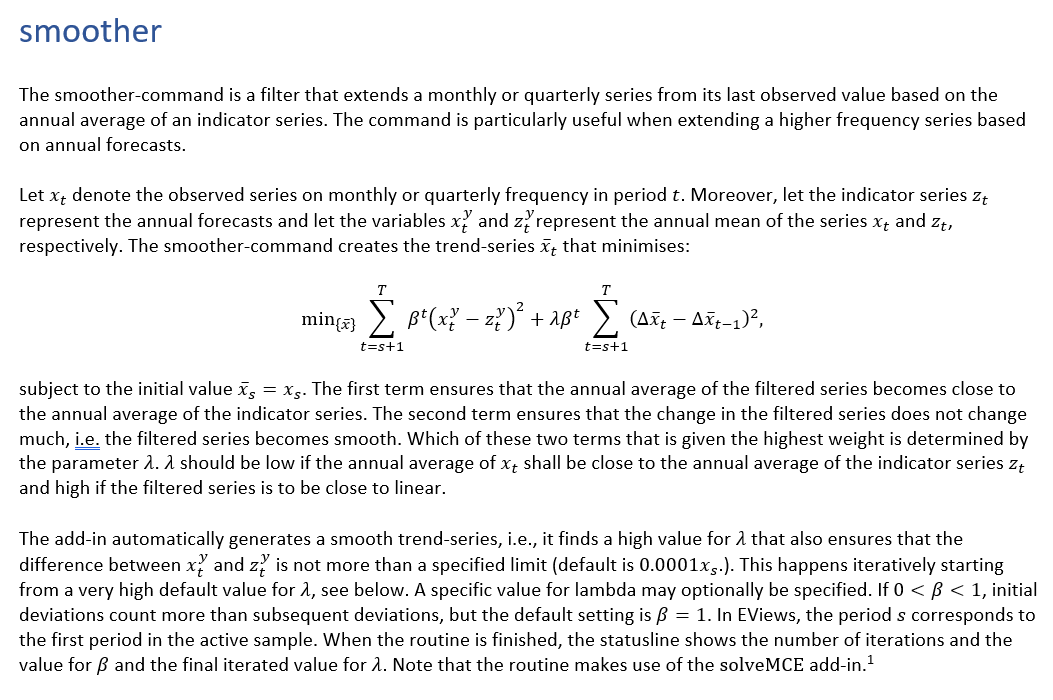

I've created a custom filter, which I've named "smoother," addressing the specific requirements I had. The rationale behind this filter is detailed below:
Please refer to the attached documentation for more information. Run the program example_1.prg to see how it can be used. You may also install it as an add-in using the smoother_install.prg file. It's important to note that the process is somewhat slow, taking a few seconds.

The smoother-filter utilizes the solveMCE add-in, as indicated in the forum: https://forums.eviews.com/viewtopic.php?f=10&t=21565. This example also serves as a reminder of the solveMCE routine's utility in solving forward-looking models and identifying optimal solutions, where instrumental variables minimize a specified loss function. These functionalities are essential and should ideally be incorporated as built-in features.
