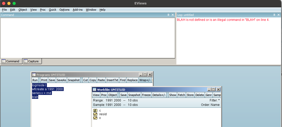

I'm not sure in what scenario the log window closes, but my test program seems to stick around, even if I introduce an error at the end.
Screenshot 2023-11-21 at 8.48.36 PM.png (50.31 KiB) Viewed 16134 times
Try giving your log a name, and it should stay around after a program run.

The log closes when the program is called from an add-in. E.g., my add-in installer program had this command:
addin(menu="Run project...", desc="Runs the project.", version="0.1") .\run_project.prg
And it's the log for run_project that would close after run_project.prg completed if it was run from the add in menu.
But your suggestion to name the log worked perfectly, so all good. Thanks Steve!
