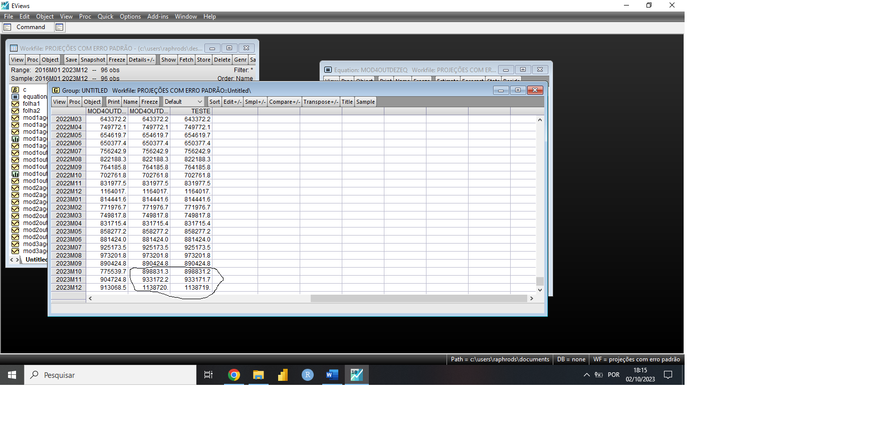

Postby rafrods » Mon Oct 02, 2023 2:17 pm
In the equation you created, change the optimization method to OPG
Thank you. It seems ok.
