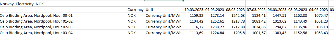

When saving a workfile, I would like to have the dates be columns instead of rows, like below:
It's preferable that this is done within Eviews, as this will be a program running on a server which periodically gives us new datasets.
Any tips are received with great thanks.

Assuming you want to save to Excel:
wfsave(type=excelxml) c:/temp/myfile.xlsx byrow
