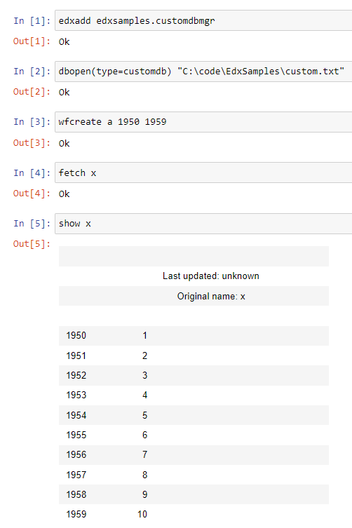

but you'll need to know the ProgId of your GSQLEDX Database manager class. Here's an example of what that looks like for our CustomDBMgr class that we provided in our EDX samples code.
You can see that after I called EDXADD with the "edxsamples.customdbmgr" class from the code sample, I was able to use it in the following DBOPEN command and then fetch a series from it.
