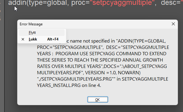

the command
addin(type=global, proc="setpcyaggmultipleyears", desc="SETPCYAGGMULTIPLEYEARS : program use setpcyagg command to extend these series to reach the specified annual growth rates over multiple years",docs=".\about_setpcyaggmultipleyears.pdf", version =1.0, nowarn) "./setpcyaggmultipleyears.prg"
has always worked. Now we get the error message:
2023-02-17 18_06_17-EViews.png (23.47 KiB) Viewed 15747 times
The code
addin(type=global, proc="setpcyaggmultipl", desc="SETPCYAGGMULTIPLEYEARS : program use setpcyagg command to extend these series to reach the specified annual growth rates over multiple years",docs=".\about_setpcyaggmultipleyears.pdf", version =1.0, nowarn) "./setpcyaggmultipleyears.prg"
seems to work .... Have you introduced a maximum number of characters for the proc-option?
Can you please take a look?
t

Postby EViews Gareth » Fri Feb 17, 2023 10:23 am
Yes, there is a maximum proc length.

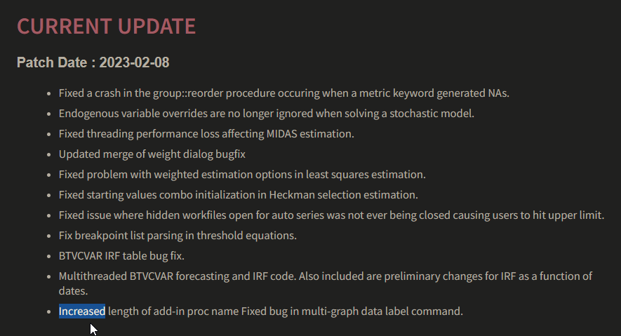

Postby tvonbrasch » Fri Feb 17, 2023 10:36 am
But is this a new restriction that has been added? This addin has worked for at least 1 year already, and now the error message suddenly appeared ...
(btw, thanks for the quick response)
t
Re: proc - addin
Postby EViews Gareth » Fri Feb 17, 2023 10:41 am
Yes, added in a recent patch

Postby tvonbrasch » Fri Feb 17, 2023 12:05 pm
Okay, thanks for the clarification! Updates that limit the functionality in EViews should come with a warning. Ideally, new updates should not introduce limitations to existing functionality at all ....
again, thanks for the swift reply
t
Re: proc - addin
Postby tvonbrasch » Fri Feb 17, 2023 12:12 pm
2023-02-17 20_11_06-EViews 13 Patch Download.png (52.53 KiB) Viewed 15726 times
btw, is "increased" the correct word? :-)
