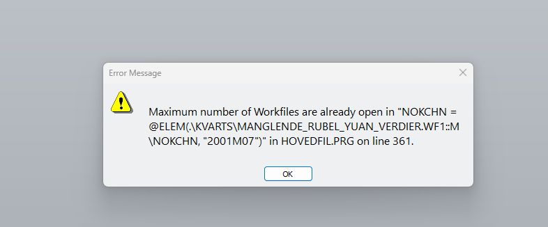

I get the following error message:
2023-01-20 12_47_48-EViews.png (21.75 KiB) Viewed 2881 times

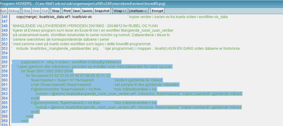

if follows from using this code:
2023-01-20 12_59_36-aw-eviews - aw-eviews - Tilkobling til eksternt skrivebord.png
2023-01-20 12_59_36-aw-eviews - aw-eviews - Tilkobling til eksternt skrivebord.png (65.02 KiB) Viewed 2881 times
suggestions on how to circumvent this issue? why is there restriction on the number of workfiles?
t
Re: maximum number of workfiles
Postby EViews Gareth » Fri Jan 20, 2023 8:21 am
I think @elem is probably not set up to read from other workfiles.
