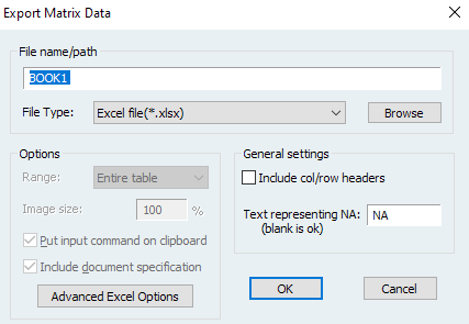

The export command for vectors does not seem to work in a fully automatised way.
The code below generates the menu window "Export Matrix Data". Clicking on "Advanced Excel Options" shows default paramter settings not corresponding to the options and parameters "cellmft", "mode" and "range" provided in the call of the execute procedure .

Postby EViews Steve » Thu Jan 19, 2023 10:24 am
Fixed. Will be available in next patch.
