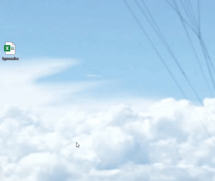

Here's a static picture of the checkbox I'm talking about:
You should be able to select the column that has all of your variable names, but here's how you would rename "series01", "series02", etc. to "prime01", "prime02":
