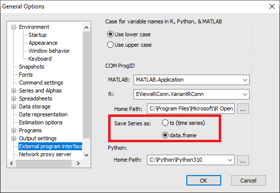

If your frequency is supported by R time series (annual, monthly, quarterly, daily, & undated), you can ask EViews to default all of your series objects to use that instead (during a save). My guess is that this option was changed to data.frame recently on your machine?
If your workfile is not a supported R time series frequency, EViews will default back to data.frame.

Makes sense, but it would be nice to also have the option on the Save dialog.
