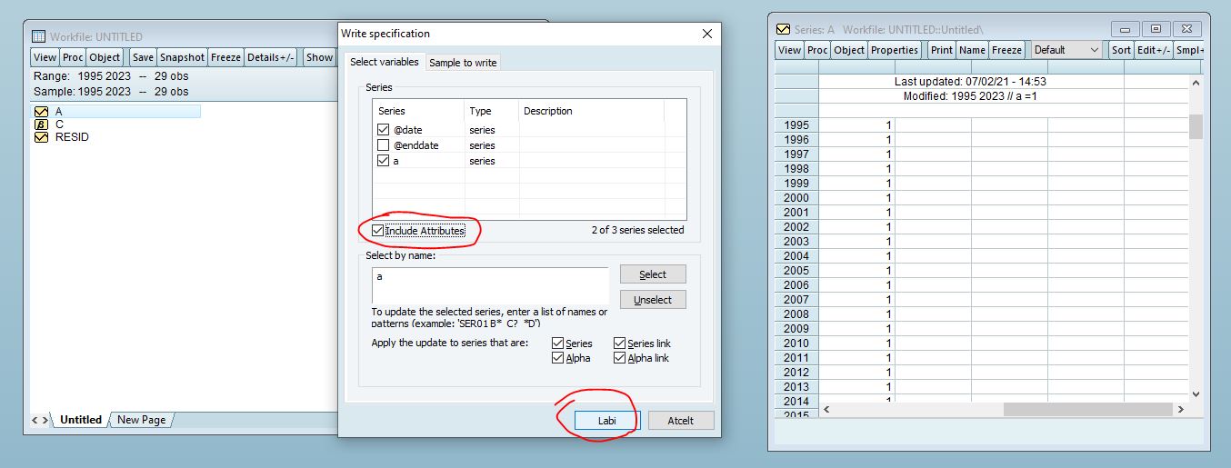

Dear Eviews,
1) I save series "A" to .csv file using command "wfsave(type=txt) hicp_forecasts.csv",
2) then diagol windows opens and I manually select series and check the box "Attributes"
3) and press OK.
4) Eviews program shuts down/disappears.
Specifically, Eviews terminates, if I check the box "Attributes", If not, then everything is fine.
Please have a look at this.
