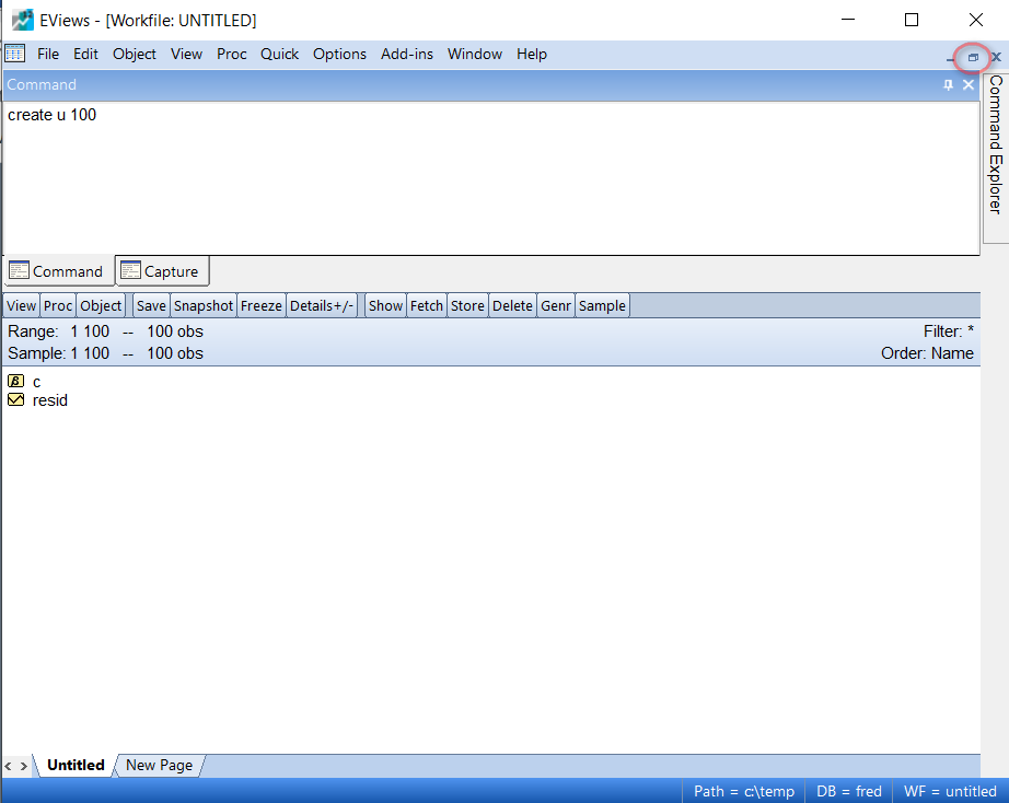

Sometimes I accidentally maximize a window, which makes it take up the entire non-command screen. I can't figure out how to un-maximize a window short of using Window>Cascade or something; but this can make me have to resize and reorganize a whole bunch of different windows if I am using a lot that day. Is there a way to de-maximize that I am missing?
I guess I could try writing "close X" in the Command window, but I don't always want to do that, and sometimes I do not really remember the name of the object that I have maximized! Thanks.

See circled button:
